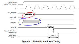

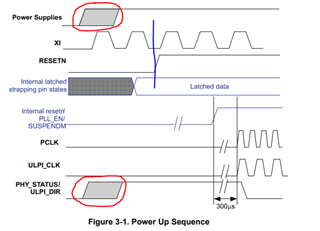

there are several questions on below power up sequence requirement.
1. what does the grey means in VDD1P1 ( blue) ?
2. what does the dotted line means in Red?
3. can OUT_ENABLE and RESETN be power up at the same time?
4. what does grey means ( in red)?
5. as you can see on blue line, does it means RESETN need to be power up after two CLK of XI or just a schematic diagram to show XI need to be before RESETN?

  • 1. what does the grey means in VDD1P1 ( blue) ?  all grey area should work.
    2: what does the dotted line means in Red?mean ULPI_DIR status unknown.
    3: should bee ok.
    4:all gray area should work
    5: xi should be before RESET
    6:How do you do write/read?
