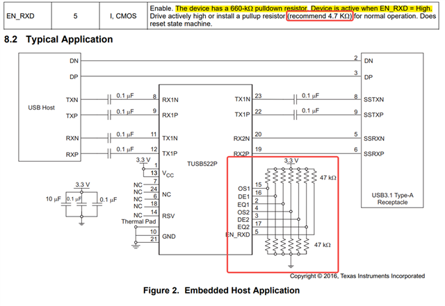

TUSB522P: Pin5 EN_RXD pull up resistor value confirmation
Part Number: TUSB522P
Hi Team,
Notice from datasheet there is a mismatch about recommended pull up value of pin 5, so which value we shall refer to? 4.7K or 47K?
