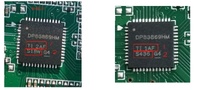

 as I know that the DIE of DP83869HM may have some change ,so customer are now receiving the first new PCN production shipments.
Due to customer R&D changes or omission of PCN, they may miss the modification of the PHYIDR2 Register (address = 0x3) value is changing from 0xA0F1 to 0xA0F3.
 So customer is currently suffering by the external SW changing in numerous products and can not meet the end customer Shipping Plan.
 That`s what i want to ask whether we can write the PHYIDR2 remain to 0xA0F1 on customer side , so customer can keep their SW not changing in this urgent time.
 tks again for your confirmation.

  • Hi Rahul:
     Tks for your comments.
     For the general purpose ,i think it is good to add an OR functionality in the driver.
     But in this time, there are so many kinds of production need customer to change the driver.
     So is there a way we can change the 0xA0F1 ID into new silicon version on customer side?
    Meanwhile, the customer has some stock available but doesn't know which marks represent what, can you help to explain the meaning of below red mark area?
  • Hi Allen,
    The Rev ID cannot be changed on the silicon, it is fixed. It can only be changed in the driver.
    Can customer read Register 3h of both PHYs ?
    Rahul
