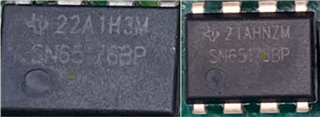

Dear Support,
Xray shows these 2 units having the same body marking, the internal die (1 is smaller than the other) and leadframe are different
Back unit Lot code: 21AHNZM
Good unit LOT code: 22A1H3M
I understand they are 2 PCNs (20210811000 and 20211229001) within in relation to DS update.
But is it normal for xray images to be so different?

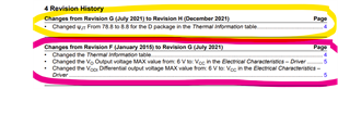

For the 2 PCN changes, which revision histroy actually involved? yellow circle or Red circle portion below?

    1. Both parts lot codes show up in our systems so I don't have any real reason to believe these are illegitimate devices.
    2. The die physically changed - so the X-Ray will also change; the new device is designed to - as best as possible - mimic the function and parameters of the old die so they are drop in replacements still.
    3. We don't characterize the impedances you measured - so we don't guarantee anything with respect to those measurements. That being said - we have noticed that the die updates we have done recently on other devices do have a change in these impedances but it hasn't caused an issue in operation for other customers - so while I can't exactly tell you what those impedances should be (as we don't have this specification characterized) - they will be different from one variant of the device to the next. The dies are physically different so the impedances can change.
    4. Both updates happened (its two datasheet updates for 1 device changed\) - I updated the datasheet - and there was a missed update value but the system already merged our updates so I had to open another revision. The Last two changes were supposed to be on  1 update of the datasheet - but due to a missed value we had to update it again resulting in the two changes seen in datasheet.
    Please let me know if there are any functional issues seen - but right now it seems like its just differences between the different dies.
