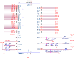

Hello TI teams,
Could you pleases help to review the sechemetic of DS90C189-Q1, just for CMS application.
thanks!

Howdy!
Some of the capacitors connected to the different VDD outputs are missing/do not have the correct values according to the EVM User Guide.
- Connected to the VDDTX pin, there should be one 10uF cap, one 1uF cap, and two 0.1uF caps all in parallel
- Connected to the VDDP pin, cap C357 should be 1uF instead of 0.01uF. In addition to this, this pin is missing an extra 0.1uF cap in parallel.
- Connected to the VDD1 and VDD2 pins, there should be three 0.1uF caps, one 1uF cap, and one 10uF cap all in parallel. Your current configuration seems to be missing a cap and the values are off.
Your PDB pin does not seem to be connected to either a pull up resistor or a grounded cap. This, is needed to ensure that PDB is not powered high before VDD is high. For example, a 1k Ohm resistor could be connected between VDD and the PDB input and a 10uF cap could be connected between the PDB input and ground For reference on the PDB power up sequence, please see figure 7-6 in this device's datasheet.
Additionally, your VODSEL, RFB, and MODE0 pins should be connected to a 10uF cap between their inputs and ground as well.
Lastly, it looks like one of your RGB inputs is mapped to the wrong pin as In_27 is left open. For the color inputs, there should be 25 total bits: 24 bits for color and 1 bit for a general purpose or L/R control bit.
This device's EVM User Guide has additional information on schematics, but if you have any other questions, please let me know.
