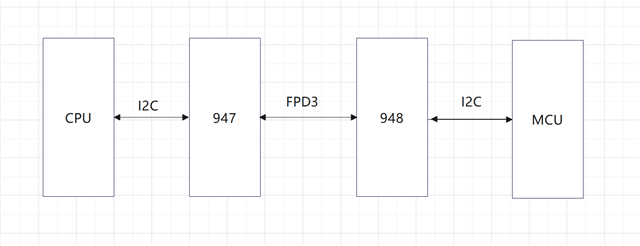

  • hi,Casey:
       out system like this,947 948 locked after power on,After the cpu soft resets the 948 through i2c Pass-Through, the 947 can access the 948, but if the 948 is soft reset through the MCU, the 947 cannot access the 948. Only set 948 register 0x03 and 0x05 to enbale i2c pass-through  ,the 947 can access 948.
    is there any difference between these two soft resets(948 0x01 write 0x01)?
  • Jia,
    You must take care when accessing 948 0x01 locally that you do not override bit 3 which is BC_ENABLE. Bit 3 can only be written via local I2C, not via passthrough. But if you set 0x01[3] to 0 then it will disable the back channel. When resetting 948 from local MCU, then use 0x01 = 0x05
