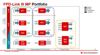

Hi Vivaan,
As I know that customer would like to use Parallel Serializer. so we have 933 or 913 can be used.
but I'm not sure that if PCLK need higher than 150MHz, Do we have solution currently? since 913/933 support maxPCLK is 100MHz. please see the detail condition as below picture.

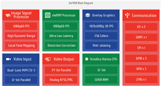

Hi Vivaan,
this case's ECU is GW4200.
GW4200 - GEO Semiconductor, Inc.
so if I choose YUV422 8bit that PCLK will be 143.5MHz. then we don't have solution can meet this value. do we have any previous case was using GW4200 ECU with our SerDes?

Hey Jimmy!
I don't think we have used GW4200 in our applications before. The only parallel serializers we have are the 913 and the 933, neither of which seem to fit the requirement for the customer, since they both support up to 100Mhz. Our CSI serializers offer higher data rates and PCLK, and can be used as an effective alternative depending on the customers application.
Vivaan

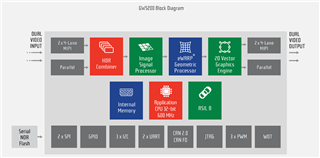

Hi Vivaan,
I double check with customer then got the block diagram as below. image sensor will use 1600*1300.
Would you please help me to recommend the IVI and ADAS serdes can work at this block diagram design? if ok to give me the reason why will choose this serdes for this design(or judge by what kind of spec) that will be helpful for me to discuss with customer.
GW4200 and GW5200 datasheet is at below. if have any spec need to know, please feel free to contact me. thanks!
GW5200 - GEO Semiconductor, Inc.

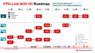

Hi Vivaan,
I think ADAS(Ser a and Ser c) and IVI(Ser b and Ser d) Ser solution will be different. would you please double check again?

Hey Jimmy!
For 1600*1300 at 30Hz, here is a list of suitable SER devices
Ser A: 935
Ser B: 921
Ser C: 935
Ser D: 941
There is a limited list of parallel SER devices. For a higher bandwidth application, the customer can consider our MIPI devices
