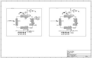

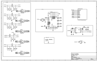

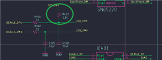

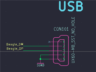

I am unable to connect to this device. I want to use a Beagle Board, but my PC can't see it either.6153.USB Hub Schematic.pdf
Does hub upstream working?, did you see c6Mhz clock on pin 30?
Best
Brian
The 6Mhz clock is working. All power and GND is accounted for. The only thing I've tried to connect to is DP0 and DM0.
I saw trash on DP nothing was on DM. So I removed the 22 ohms in-line protection resistors to get a raw look at the USB signal. Nothing. No heartbeat or wake-up command, nothing. Then I read about how USB works and that there must be a pull-up resistor on DP in order to have positive differential voltage. Well that makes sense, plugging in a USB device wakes up the host and a low to high signal could do that. Then I returned and placed the 22-ohm inline resistors (U401 & U402) back on the board. That shorted out the 3.3V rail (crap!). Now I have another board populated with nothing but the components on the schematic you have in your possession.
Stand by for an update after that is done...
Thank you,
Brian,
C411 has shorted to ground. Removing that cap make my PC say that it cannot identify the chip.
I thought you already have 1.5k pullup on DP0, if C411 as shorted, then no .3 supply for the hub.
Best
Brian
Right.
R401 and R402 was removed by me (my bad). R401 and R402 were reinstalled, C411 was removed and there was communication from the PC to the TI chip. The PC did not recognize the chip as a USB hub.

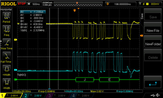

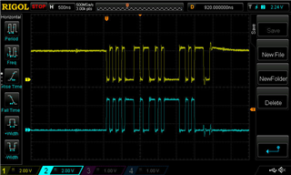

Per your request see the attached waveform. Now this happens about 5 times and then the PC tells me it doesn't recognize the hub.
Also, I've tried other interactions and got different results. I plug the hub into my PC and this waveform happens DM stays low. I plug the hub into the Beagle Board and DM goes to 5 volts and no square wave. I plug a different computer into the hub and it does the same, DM goes to 5V and has no square wave. Why is that?
pin 4 is ID pin, if Gnd means it's host device, but 2046 is hub. So pin4 shoud be floating.

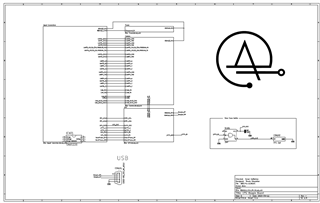

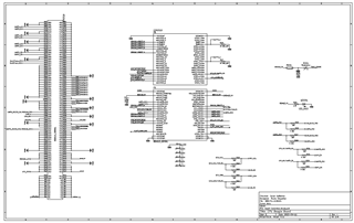

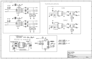

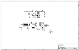

do you have USB analyzer to take trace? or send full schematic ?
Best
Brian
I do not have a USB analyzer. I do have the full schematic. It seems the chip is acknowledging with no results. Your file upload isn't easily used so...
hard to read, can you accept my friendship request and send to priivate message?
