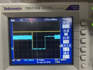

We found a new issue:
The clock which input to 947 will pull down almost 30-40ms in some usage case, so we want to know:

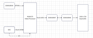

    Below is our block diagram, when we switch the video signal input to 86175 between the 934(use for 360 panorama) and soc,
    the CLK which input to 947 will pulled down almost 30ms, in this time the lock signal is always at high level,
    but the panel display is error.
    Can you give me any suggestions about this? Is it cause by 947?

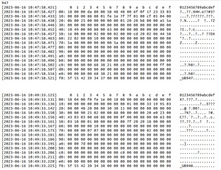

    And this is the reg data of 947 and 948.

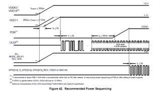

    The issue is caused by the video processor 86175 LVDS CLK output signal. It's getting stuck low when you mux between the 2 inputs.  The 947 has no impact on the input signal, the requirement is for the OLDI (LVDS) CLK to be continuous during normal operation - see power-up sequence recommendation for 947. Section 9.1 in the datasheet.
    We had already make sure this issue caused by 947, because it can be resume if we reset the 947.
    If any disruption to the CLK happens during normal operation, you need to reset the 947 that is expected behavior. FPD-Link will not auto adjust after CLK drop. Please follow up with the ML86175 team to investigate root cause of why the CLK is dropping during video switch.
