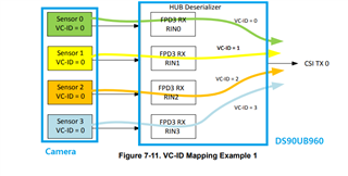

I had used the DS90UB960 like below block diagram.
And, It works very well. ( used the 4 camera )

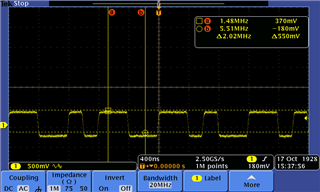

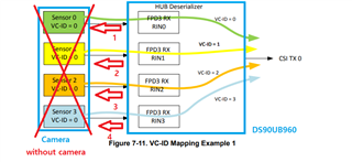

But, when it's without camera, I find some signal like below picture 1,2,3,4 numbers
It's 50pin(RIN0+), 53pin(RIN1+), 59pin(RIN2+), 62pin(RIN3+).
This some signal is like below picture
Please, let me know this signal.
What is this signal used for ?
best regards,
hosung shin.
  • Hi Hosung,
    The signal you are observing is the back channel signal. It is used for communicating from the deserializer side to the serializer side, in your case, from the 960 to the camera modules. This signal can be used for many things, like I2C communication, lower speed data transfer, etc
