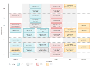

    It's hard to say since we don't spec phase noise. We do have the EVM for this device, you could provide the TTL signal and see if the differential phase noise meets your requirements.
    Have you looked at our Clocking Buffers on ti.com, in particular the differential buffers? These devices have phase noise numbers since they come from our clocking team. For LVDS output types, one drawback is the minimum output channels is 4.
