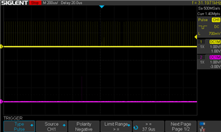

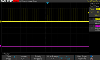

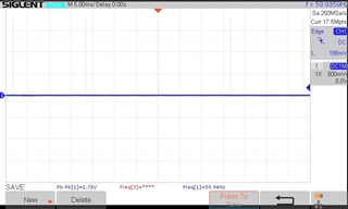

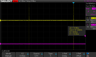

  • Hello, thank you for answer!

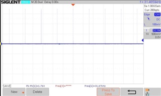

    we have maped HSYNC and VSYNC and measured their frequency.
    Mode 6(480p) works fine.
    Modeline "Mode 6" 27.027 720 736 798 858 480 489 495 525 -hsync -vsync
    Measured HSYNC=31.47kHz, VSYNC=59.94Hz

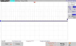

    Mode 3 (720p) is blinking and we  observe fail flags: DPTL_UNEXPECTED_VSYNC_ERR, DPTL_UNEXPECTED_HSYNC_ERR, DPTL_UNEXPECTED_PIXEL_DATA_ERR, LOSS_OF_DP_SYNC_LOCK_ERR, CHA_SOT_SYNC_ERR.
    Modeline "Mode 3" 74.250 1280 1390 1420 1650 720 725 730 750 +hsync +vsync
    Measured HSYNC= 45kHz, VSYNC=60Hz
    Mode 1 (1080p) doesn't work at all and we observe fail flags: DPTL_UNEXPECTED_VSYNC_ERR, DPTL_UNEXPECTED_HSYNC_ERR, DPTL_UNEXPECTED_PIXEL_DATA_ERR, LOSS_OF_DP_SYNC_LOCK_ERR, CHA_SOT_SYNC_ERR.
    Modeline "Mode 1" 148.500 1920 2008 2052 2200 1080 1084 1089 1125 +hsync +vsync
    measured HSYNC= 67.5KHz , VSYNC=60Hz

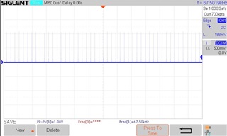

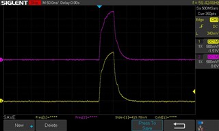

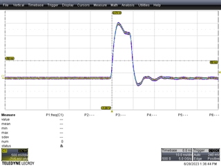

    Thank you for sharing these. Can you please also include the register dump?
    Also, can you put the scope in persistent mode when you measure HSYNC and VSYNC? This would ensure that HSYNC and VSYNC are constant.
    Thanks, Allison

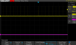

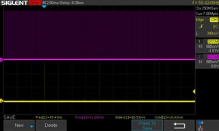

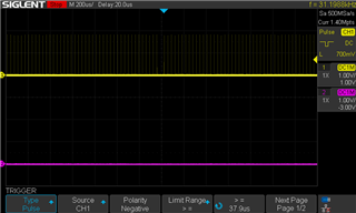

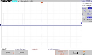

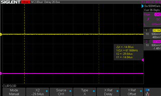

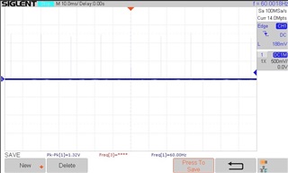

    HSYNC и VSYNC persistent mode, for 1080p that doesn't work
    And registers dump for different modes.

  • Hello, David.
    Ok. We can try with Google drive https://drive.google.com/file/d/1PbUMf8JIPHymMZ_962GIZgk-ZVDiYLDK/view?usp=sharing
    We did that. HSYNC  persistent mode, for 1080p
    HSYNC= 67.5KHz for 1080p
    Best, Aliaksandr

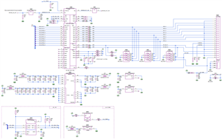

  • HI,
    We don't really have a way to check what DSI data types Resesas SoCs are using, but we do have two similar 480p modes ("Mode 6" 27.027 720 736 798 858 480 489 495 525 -hsync -vsync and "Mode 9" 25.200 640 656 752 800 480 490 492 525 -hsync -vsync) and mode 6 works but mode 9 doesn't. I think both modes use the same DSI data types.
    We tested the 27MHz clock and it runs at the correct frequency. Moreover, we tried 19.2 MHz and 38.4 MHz with the same result.
    I can share this part of schematic:
    Best ,Aliaksandr
  • Hi Aliaksandr,
    The schematic looks OK, thanks for sharing it. Can you measure the HSYNC to VSYNC timing using a scope? You can map HSYNC and VSYNC to the GPIO pins. It would be helpful to know if HSYNC-VSYNC timing > HSYNC-HSYNC timing.
    Thanks, Allison
    Thanks for answer.
    I don't quite understand what that means "HSYNC-VSYNC timing > HSYNC-HSYNC timing". Could you please explain.
    We measured the HSYNC and VSYNC from the bridge GPIO (yellow channel is VSYNC and violet channel is HSYNC). Both signals arrive at the same time.
    Is that what you were asking about?
    Best, Aliaksandr
  • Hi Aliaksandr,
    Please refer to the picture below. Can you check if t2 > t1?
    Best, Allison
    We see that both signals (HSYNC and VSYNC) occur synchronously (simultaneously). This is the bridge GPIOs output where yellow channel is VSYNC and violet channel is HSYNC
    And we see the same picture with the working mode (like 480p) and with the non-working mode (like 1080p)
    Best, Aliaksandr

    Thank you for support.
    Additional Information what we have found.
    For the non-working 480p (Mode 9), we found hsync skips.This happens about once every 1-2 seconds.
    For working 480p (Mode 6) there are no  hsync skips.
    It remains to find the reason why the hsync is skipped.
    Best, Aliaksandr

  • Hi Allison,
    Yes, we see skips on 720p and 1080p modes as well
    We measured the HSYNC to VSYNC and HSYNC to HSYNC timing using a scope and saw that  t1 = t2 (like your picture above)
    Picture with HSYNC to VSYNC
    Picture with HSYNC to HSYNC
    Best, Aliaksandr
  • Aliaksandr
    Can you contact Resesas for support on how to program their DSI SOC?
    In Table 8-6 of the DSI86 datasheet, we need to make sure the timing between Horizontal Sync Start (HSS) is maintained. If you are seeing HSYNC skipping, then the SOC is not sending the HSYNC at a regular interval.
    David
