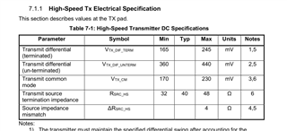

From the datasheet the eUSB output on the TUSB2E11 device is ~400mV differential.
Per the spec, the terminated is called out closer to ~200mV, and unterminated is ~400mV.
Why is the swing for the device set to 400mV rather than 200mV?

  • Hi Nicholaus,
    Thanks for this.
    As I read it, the common mode is set to 200mV for this interface (VE_TX_CM in your datasheet, matches VTX_CM in the eUSB spev).
    So even if Vpp is 400mV, this would imply:
    VTX_eD+ at 400mV,
    VTX_eD- at 0V,
    Differential swing is 400mV. ({200+200} –{200-200}) ?
    This would be different if the CM were 300mV for example, then Vpp diff of 400mV could imply:
    VTX_eD+ at 400mV
    VTX_eD- at 200mV ,
    Differential swing is 200mV.({100+300} – {300-100})
    Can you please confirm which it is ?

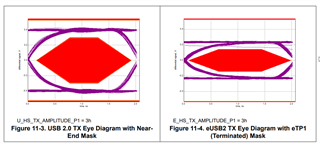

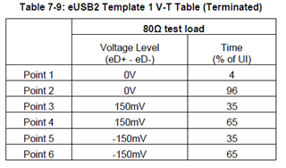

  • Hi Austin,
    You can refer to the Figure 11-4 eye diagram in the datasheet to see that the differential is ~400mV.  The TX eye mask in the eUSB specification uses this type of measurement (eD+ - eD-), and it must be greater than 300mV.
    This is the idea behind the ~400mV TX_DIF in the spec.  The USB spec values in the datasheet are defined the same way at 800mV.
    I passed along the recommendation that the datasheet spec should be updated to avoid confusion in the future.
