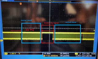

I used the DS90UB960 like below block diagram.
And, It works, also it's the mipi signal in this state. ( Picture1 )
[Picture1]

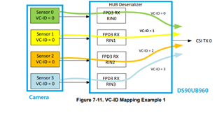

Aslo, the picture3 is an enlargement of picture2
[Picture3]
I think that this MIPI signal was broken by ESD (Electro Static Discharge)
Please, advice for this ESD test ?

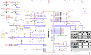

  • It's our schematic for DS90UB960.
    best regards,
    hosung shin.

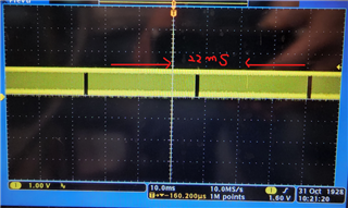

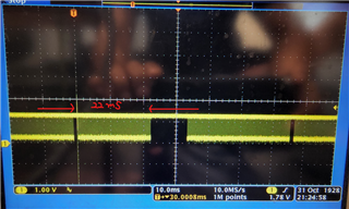

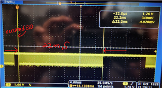

       >> When the mipi signal was broken, it's very short time like below picture
           the RED box is broken signal.
           then, I can't read this register on this time.
