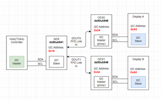

Hello Experts:
The block diagram of our system is as follows:a
ds90ub948s I2C have  the same address 0x34,and displays also have the same address 0xA0.
Can soc access them independently?Is this a reasonable design solution? thanks.

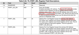

I'm a little confused about this register,TX_PORT_SEL Register (Address = 0x1E) ,What does the primary I2C Address and The second I2C address refer to here?
