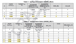

1, 949 C1-C4 note 50WV, 0402, what’s the meaning of 50WV?
2,configure PIN add 0.1u, when the sampling time? If the up resistor bigger, power up RC will need time.

1) WV stands for "working voltage", it is essentially the max voltage that the capacitor should handle.
2) We do not have a recommended sampling time for those capacitors, I would recommend looking at section 9.1 in the datasheet where it goes over the recommended power-up sequence. After a PDB reset, there is no additional wait time needed.

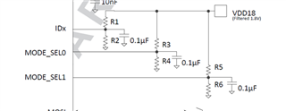

question2, I want to know 0.1uF, if RC need long time, example R3 =118K, R4 = 30.9K, so RC = 118*0.1,it need time for charge the 0.1uF, i want to know the time for IC internal sampling these, it must bigger than RC charge time.

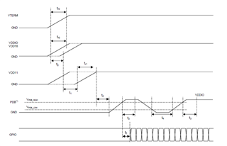

after PDB, it's sampling ok? so time between power up VDDIO and PDB the sampling down ? but t2 minimal 0ms.
Hi Songlin,
Per the datasheet sampling, the PDB signal must go high after the power rails are stable and high. After this point, yes, sampling is okay.
Cameron Carlson
Hi Songlin,
There is no sampling time for powering on the device, as there isn't a set polling/sampling rate that the device checks PDB at.
Please refer to the power sequencing for proper operation of the device. PDB must be high after power supplies are fully high and stable (>0ms), but outside of this there is no sampling time requirements from VDD to PDB high.

Hi Songlin,
There is a 2ms delay time required between PDB high and programming the device.
Otherwise, we do not characterize a "sampling time". As long as PDB is high only after VDD stable (represented by T2) and 2ms is waited before programming I2C (represented by T3); then all sequencing and sampling requirements are statisfied concerning PDB.

Hi Songlin,
Yes, 0.1uF is what we recommend for those pins for any pullup resistors specified in the datasheet.
