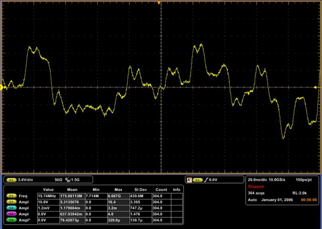

  • HI Gokul-san,
    Sorry for the late confirmation.
    I attach the data measured by the customer and the comments.
    Although the waveform looks distorted due to probing, it is confirmed to be 1000Base-T 4D-PAM5 code.
    Please check the attached waveform data.
    There may be a problem with register settings, so it would be helpful if you could tell me the procedure.
    Hiroshi
  • Hi Hiroshi,
    I meant if there is activity on RX_D0, RX_D1, RX_D2, RX_D3, TX_D0, TX_D1, TX_D2, TX_D3.
    If there is activity, these signals toggle and LED should also toggle.
