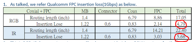

Hi team,
customer want to use this as CSI retimer between CPU and camera,
there's a 24inch coaxial cable with 40AWG,
can you help analysis the loss and see if we can compensate
BTW, the CSI data rate is around 1Gbps
Fred

Do we know how much is the loss for this 24in coaxial cable? The maximum equalizer compensation we can provide is 4dB at 500MHz.

Hi David,
here's their analysis, both signa losses are larger than maximum 4dB EQ,
obvious we need some pre-emphasis support,
does this mean I can't place the retimer too close to CPU, so I can leverage TX driver's pre-emphasis, right?

Not yet it’s very early stage, they will use two of our retimers, one for IR camera the other for RGB.
but what I trying to say is we should leverage TX if we want to compensate 5.68dB,
so we should spare some length between CPU and retimer , right?
You could use the TX pre-emphasis to provide compensation. But the DPHY440 RX also provides de-skew function. So any skew on the TX side will not be de-skewed.

No. Please see the example below
If I have a 5in input trace, DPHY440 RX will able to provide de-skew function for the 5in input trace.
But if I have a 3in input trace and 2in output trace, DPHY440 will only able to provide de-skew function for the 3in. The skew for the 2in will not be compensated by DPHY440.

For the 5in on the RX side, you will use RX EQ to compensation for the loss. You will only enable TX pre-emphasis to compensation for any trace loss at the DPHY440 output.

But what if RX EQ gain is not enough,
And we need to leverage TX pre-emphasis?
shouldn’t we consider move redriver closer to TX a bit and enable pre-emphasis?
I honestly don't know if TX can provide pre-emphasis compensation for the under-equalizer input signal in this case.
But the DPHY440 should be placed to maximize its RX EQ and de-skew capability as much as possible.

Hi David,
it’s alright, since it’s not linear redriver, i assume and guess it may not compensate for under-equalizer input signal .
anyway I will recommend them place at CPU as close as possible,
