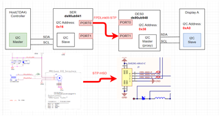

      Sedes 941 register 0x6 can read remote 948 ID value 0x70,and  i think the FPD-LINK /I2C physical line connect well.
      However, the 948 register viawe cannot be read & write via I2C, failure eror reported,  and what's this isue and how to read/ wirte remote register?

          Thanks for you reply.  We use TDA4 EVM + customer display board with DS90UB948-Q1,  a STP line is used to connect port 0 of 941AS and port 1 of 948 and configed normal mode.
         Now there is no DSI source conected and use pattern generator mode to test firstly   the  0x1 resgister of 941AS is set to disable DSI. Besides, the register 0x64 of 941AS is set to enable pattern generator mode, also set 0x3 I2C pass through , 0x17 i2c PASS ALL.
        So if there are more registers need to be set in this way using, also like you said, this maybe caused by the forward channel link issue , then how to check it ? Look fprward your professioanl advice to deal wth this issue~~

    The 948 is designed to use port 0 if it is operated in single link mode. If you need to use port 1, then you will need to locally reconfigure the 948 to use port 1 for single link mode (can't be done through the FPD-Link remotely).
    Set 0x34 = 0x1A to force single link port 1 mode (program to the 948 locally)
