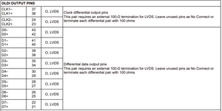

Hi team,
The customer have a display screen project with 948. When doing the TFT power-on sequence, they found that: LVDS will output a high level to the screen as soon as the 948 is powered on (green in the figure below), which leads to backflow of STB RST and other signals of the screen. What is the reason for this LVDS pull-up, and is there a way to turn it off?
