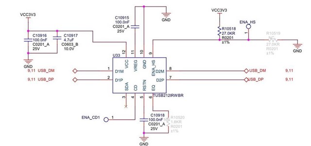

Q3 Could you please help me review this schematic?
The schematic diagram is as follows:
    One thing I noticed here is that one of the capacitors is 4.7uF, when our typical application specs that capacitor to be 1uF in the datasheet. Changing that may help prevent issues that could occur during the power-up process.
