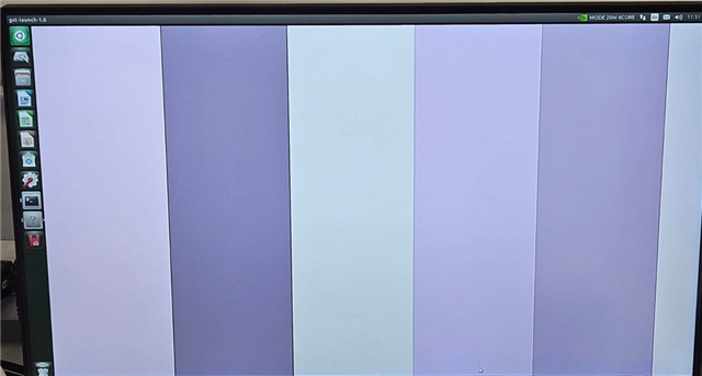

We have a system which includes a camera with the 953 serializer, connected via cable to a setup with the 960 deserializer driving a GPU.
In nomal operation we can see the images from the camera as received by the GPU, however when we try to set pattern generation for the 953
serializer, there is no image displayed.
We have used the code example as shown in section 7.6.4 in 953 datasheet.
Do we need to set anything in the 960 different from the normal operation configuration?
    We have tried setting pattern in RAW 12 mode, using another thread on this forum (linux-ds90ub953-q1-help-about-pattern-generation-of-ds90ub953) and we were able to see image, although resulting color bar is not as expected (colouring is pinkish...)
    So now there are 2 questions - (1) what is the reason that the example described in section 7.6.4 in datasheet didn't result in image,
                                                      (2) what is the reason we do not get the colors in color bar
    Thank you for your questions. Additional configurations should not be necessary on the 960 to receive data from the 953s pattern generator. Is your GPU programmed to receive a specific data type? The code example in the datasheet results in a 1920x1080 with 30fps and RGB888 data type. It's possible that your GPU may not be able to receive this data type/resolution, but is able to receive the data type/resolution of  your camera. Similarly, the RAW12 data may not be entirely recognizable/usable by the GPU, which is why you see unexpected data instead of no data at all. Could you double check the GPU and/or camera settings for any specific data type or resolution requirements?

    For the 1920x1080, 30 fps, we got the the color bars with a pink background as shown below:
    The code we used (for RAW12, 1920x1080, 30 fps, 8 bars)

    Later we changed for RAW12, 1280x1080, 30 fps, 8 bars, and while number of displayed bars is now 8, the bars colors are similar to the image attached.

    We suspect some mismatch in the programming of the pattern generator.
    Could you please advise?

    There does not appear to be any issues with your code based on the parameters you specified. Based on the image it looks like this may be more of an interpretation issue instead of a pattern generator code issue. Is the CSI receiver set up for a specific color mode? Is the CSI receiver expecting anything specific in a software sense? Can you try generating the pattern generator from within the Analog launch pad instead of setting registers through a pre-written script? This will help ensure that the pattern generator is programmed correctly. Is the same result seen for the pattern generator if it comes from both the serializer and the deserializer?

    Another question - is there, by any chance, any screenshot available for a RAW12 pattern generator output image, at any resolution? (for reference)
    Currently I do not have a screenshot for RAW12 available, but let me reach out to other members of the team to see if one may be available.
    We unfortunately don't have a screenshot available to share. Have you made any progress on the CSI receiver's settings?
