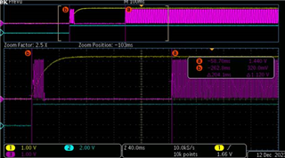

I am implementing a USB HUB using the schematic in datasheet without an EEPROM. I cannot connect this USB to a laptop, one day I got windows notification that USB Malfunctioned, but now I does not appear at all.
Below is the schematic attached as well.
Below is the operating voltages of USB Hub in circuit.
