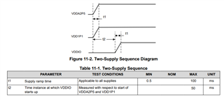

Dear team,
We can see power sequence at datasheet of DP83869HM like below.
The recommendation is to power all supply. If that is not possible, then the following power sequencing must be used.
But VDDIO voltage start up time is max 50ms but there is no min specification. If VDDIO supply is regulated ahead of VDDA2P5 and VDD1P1, Is there an expected side effect? Please let me know your opinion.
