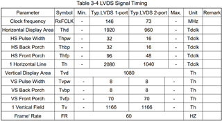

     it's my first time to use 947 for IVI. LCM use 940. dump 940 and 947's registers, 947 linked 940. when I set BIST mode to 940,the link will lost. I2Cdump 0x2c, will be response No  I2C ACK .
    my LCM parameter:
     please give me the BIST's register value
    my question:
    How can I set the lcm's parameter in 947, I don't know the page 10 and page 14' register. would you help me?

  • Hi Esin,
    What is LCM?
    Are you supposed to use two displays LVDS 1-port and LVDS 2-port as in the table you shared? Note that 947 can act as a 1:2 repeater, meaning it can push the same video to two deserializers, not possible if the two displays have different clock frequencies.
