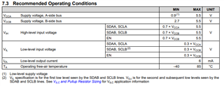

TCA9517 use to A and B +3.3V.
SDAB/SCLB spec value
VIL=0.3*Vccb=0.99V(max)
VILC=0.4(typ)
On the other,
SDAA/SCLA does not mention VILC.
Q1: What condition shold VILC standard value provision be applied?
Q2: example, apply for Clock Streching?
I showed datasheet under below.
7.3 (2) VIL for Port B.
7.5 SDAB, SCLB =0.4V(typ)
9.3.3 VOL B-side Offset Voltage
10.2.2.2 VILC and pullup Resistor Sizing
