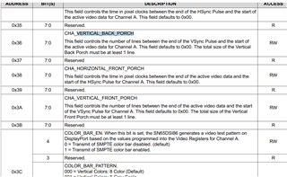

What is the required range of video format parameters?(HPW/HBP/HFP、VPW/VBP/VFP)
1. I see from the datasheet that these registers are 8 bits, are they support up to 255?
2. What is the minimum support?
Part Number: SN65DSI86
Hi TI,
HSYNC pulse width can be in the range of 0 <= HPW < 32767 pixel clocks, as the HPW is defined as a 15bit value. HBP and HFP can be in the range of 0 <= HBP, HFP < 255 pixel clocks.
VSYNC pulse width can be in the range of 1 <= VPW < 32767 lines. VBP and VFP can be in the range of 1 <= VBP, VFP < 255 lines.
