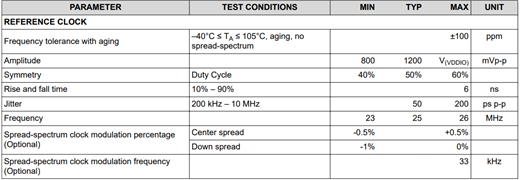

    SSC oscillators can be used by the 960 so long as the oscillator meets specifications. These specification are listed in section 7.4.4 REFCLK:
    SSC is used to mitigate EMI/EMC issues and has been observed to improve results. The change is largely system dependent and we do not typically suggest one over the other.
    To enable spread spectrum you must use the serializer in synchronous mode and apply a spread spectrum REFCLK to the deserializer side which will have the effect of spreading both the forward and back channels for the SERDES pair.
