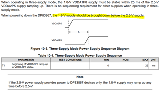

I received a question about the powering down sequence from the customer. If turned off in the order VDDA1P8 -> 2P5, is there any risk of device damage etc?

There is risk if this procedure is not followed as the 1.8V can potentially backpower the 2.5V rail, thus potentially damaging anything else sharing the 2.5V line.
