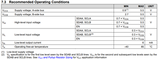

Hi, team.Please follow datasheet interpretation.
Q1: If system device use  VOL=0.4V,
which of the datasheet TCA9517 side should
Look at:(Vccb=3.3)
VIL(=0.3*Vccb=0.99V(max))
or
VILC(=0.4V(typ))
Q2:I think VIL would be fine, but in what kind of situation should VILC be used.
  • The specified VIL value for SDAB/SCLB is explained in footnote (2), but it is meaningless for you. You need to use the lower value, which is always VILC.
  • Hi Katsumi,
    Clemens is correct about the footnote. VIL for the B-side is the specification for the first low level seen by the SDAB and SCLB lines. VILC is for the second subsequent low levels seen by the SDAB and SCLB lines.
    All devices connected on the B-side of the I2C bus should be able to drive an output low voltage level below the typical VILC spec (0.4V). VOLB = <0.4V for all devices. This spec must be adhered to so that the device can properly determine which side is driving a low-voltage signal in order to not lock the I2C bus.
    TI specs the VIL = 30% of VCCB because this is the spec listed in the I2C standard. For this particular buffer, an additional requirement of VILC is needed for proper operation of the device.
    Tyler
