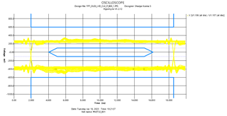

We are performing Hyperlynx SI Simulation for DS90UB928Q-Q1 Deserializer and FFC model. I am attaching FFC model for your reference.
While simulating by connecting both deserializer and connector we are getting voltage swing around 600mV. But while simulating without connecting the connector we get the swing of around 400mV. This is simulated in differential. the register setting in the IBIS model the register settings are in default 400mV (0x4B = 00)
Without connector the swing is around 400mV,
But with connector the swing is around 800mV

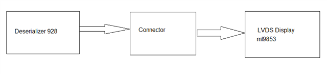

Here are the following simulation setup:
 1. The Deserializer 928 is connected to the Connector and the connector is connected to a LVDS display. the LVDS display will have a inbuilt 100 ohms termination resistor.
2.  Clock Frequency- 30.13MHz, OLDI Rate- 210.9 Mbps
3.  Impedance of the FFC Model is 242 at 30.13MHz.
