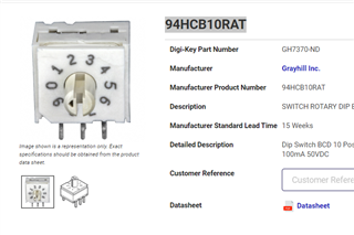

  • Hi Clemens,
    There is no position "0" in the schematic
    Below is the image of switch and truth table:
    What are the values of the TCA9555's configuration registers?
    Can you please comment on the temperature issue? Is this heating effect is normal or not?

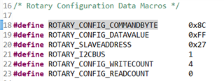

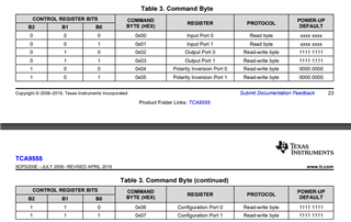

  • The slave address appears to be correct. But I do not understand the value 0x8C for the command byte; the only valid values would be 0…7. Please show the code that initializes the TCA9555's registers.
    Like Tyler, I suspect that the pins are configured to output a high signal, which makes a large current flow when the line is shorted to GND externally. Please read the values of all eight registers.
  • Hi Clemens,
    All the pins are configured as inputs at present. The value 0x8C is not clear to me as well, as this is a reference code, but I will try changing it to the address of configuration register and see if there's a difference.

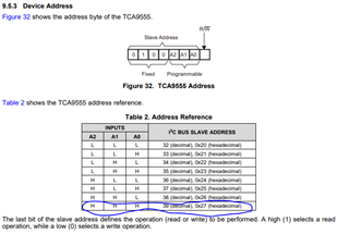

  • Hi Kiran,
    I agree with Clemens. Slave address looks to be correct with A2/A1/A0 = H, as depicted in the schematic.
    The 0x8C is not the correct address for the configuration register. To access the configuration register for ports 0 and 1, the command byte needs to be set to 0x06 and 0x07 as described in the datasheet.
    A read of the input port register (0x00 / 0x01) will reflect the incoming logic levels of the pins regardless of whether the pin is defined as an input or output by the configuration register.
    A read of the output port register (0x02 / 0x03) will reflect the value inside the flip-flop controlling the output selection. Not the actual pin value.
    A read of the polarity inversion registers (0x04 / 0x05) will show the contents of the polarity inversion registers (default = 0x00).
    A read of the configuration registers (0x06 / 0x07) will show the contents inside the configuration register telling the user what p-ports are configured as outputs or inputs. If an output, the corresponding bit will read "0", if the corresponding bit is an input, the read will yield "1."
    A read of the configuration register upon power-up without any device configuration should read the value 0xFF, since default state of the p-ports are inputs upon a successful power on reset condition.

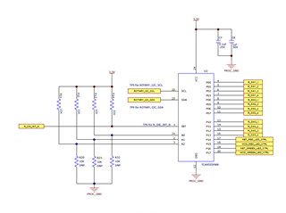

  • Hi Clemens and Tyler,
    Sorry for late response.
    We were investigating this issue on hardware and firmware level.
    Schematic as follows:
    The Green highlighted port acts as an output port and the remaining act as an input port.
    We have two PCB boards which have the same design. But one board has TCA9555 IO Expander and the other board has CAT9555FYI.

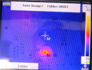

    When we did a thermal analysis of both boards.
    1. TCA9555 IC heated up to 61 degrees.
    2. CAT9555 IC heated up to 41 degrees only.

  • Hi Clemens,
    Thanks for your response!!
    Below is the thermal profile of TCA9555.

  • Apparently, the code confuses the output port registers (2,3) and the configuration registers (6,7).
        stI2cData.pui8DataRx = ui8RxBuf;
        ui8TxBuf[0] = 0x06;
        ui8TxBuf[1] = 0x00;
        ui8TxBuf[2] = 0x00;
        stI2cData.pui8DataTx = ui8TxBuf;
        i2cTivaLibTransfer(&stI2cData);
    This configures all sixteen pins as outputs. But the pins that you want to be inputs must be configured with 1 bits:
        ui8TxBuf[0] = 0x06;
        ui8TxBuf[1] = 0xFF;
        ui8TxBuf[2] = 0x0F;
    (The symbols in the second file are not actually used. You should clean them up.)

    To address the issue concerning the 61C, this is still underneath the TA temperature. As long as ICC current or maximum output current through the GPIO's is being respected, then this temperature is okay for the device. Main thing to keep in check is the current consumption, and that it doesn't exceed abs. max conditions.
    TCA9555 compared to the CAT9555 device from ONSEMI might just be output strength differences, die differences, there really is no one clear answer to why the current consumptions are different other than they are different parts with different designs, with similar functionality.
    Is the temperature of the TCA9555 chip affecting your system in a negative way, or are you just curious for a reason why the temperature is higher than the ONSEMI part?
    Tyler

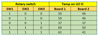

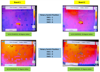

  • Hi Tyler,
    Thanks for your response.
    In the coding IDE, can you store the read value inside a variable or int and then read that storage container inside the IDE?
    I will try.
    >> If it continuously works on higher temperature then it may degrade the life of IC and functionality.
    Below is the temp. variation on IC with respect to position of rotary switch. (Schematic already shared in question itself.)
    Both boards have same design, only has different IO Expander IC.
    Please share your comments to identify the root cause of this heating issue.
    Kiranjit
  • Hi Kiranjit,
    There is no exact way for me to isolate the root cause of this heating issue. It may be that the silicon of the CAT9555 is better designed, and has better heat dissipation than the TCA9555. If this issue was of a concern across two TCA9555 devices that were of the same silicon but resulted in different IC temperature, then I would be curious to know why this is happening.
    Because it involves two chips from two different manufacturers, I not sure what could be the result of the heating other than that the CAT9555 might be a better design for heat dissipation.
    Just a quick look at the abs. max specs of both datasheets. CAT9555 is rated for 150C, and TCA9555 is rated for 100C abs. max. Just off of this, I am sure there are major internal differences between the two devices that would cause the abs. max junction temp to be 50C > than the TI device.
    My only suggestion is to use a switch that has a weaker load. It seems the rotary switch is drawing too much current in certain positions.
    Tyler
