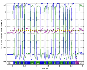

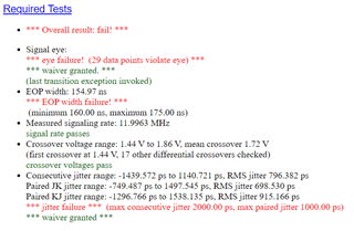

I performed the "official" Signal Quality measurement with the LeCroy QualiPHY Test Rig and Oscilloscope and received the following results in the pictures below.
The following problems occured:
- Eye Diagram is not fulfilled. It appears that the last rising edge (also part of EOP?) cuts through it
- End-of-Package Requirement not fulfilled. EOP is too short
- Some problem with Jitter requirements

  • Hi Brian,
    i made a quick test and removed the daisy-chain on my pcb. The eye diagram improved (no violations anymore, but quite close), but the EOP failure is still present. Do you have any idea what could be the root cause for the EOP failure?

  • Hi Gregor,
    The downstream test also passed everything.  EOP was measured as 162.42ns.  What test fixture, cables, and oscilloscope are you using?
    Nicholaus
  • As you can see in my test the EOP was measured 154.22ns. I used the Test fixture from LeCroy, and used 5m USB cables where needed as described. Do you know what could influence this?

  • Hi Gregor,
    Thank you for this test; breaking down the EOP timing for each hub is very helpful. Two bit periods (166.6ns) is an ideal SE0 width for the EOP of a hub.
    Your EOP width drops by ~6ns after the first hub, which is significant as it must stay between 160ns and 175ns. Relevant information is found in section 7.1.13.2.1 of the USB 2.0 specification.
    In regard to the test methods, yes, the LeCroy document you sent showing 5 hubs is correct for official FS compliance. My setup includes all of the same elements, but the number of hubs may be reduced for debugging purposes, as you have done.

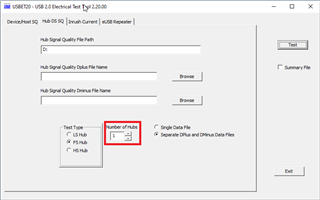

    There is one interesting option I see in the official USBET20 v2.2 compliance software.  It allows you to select the number of hubs in your test.
    I have never used this option and always followed the "5 hub" rule, but I have e-mailed USB-IF to see why this option is available.
    Nicholaus
  • Hi Nicholaus,
    to be honest, i don't know what that setting with the number of hubs is, either. In the LeCroy Testing Software it's called "Tier". I played around with it but it didn't have any impact on this EOP measurement. But i would wonder what it means if you get an answer from USB-IF.
