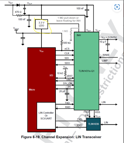

Hi team,
We found in all the channel expansion examples, 3.3V external LDO is used. We want to know why. Why 3.3 LDO output of TLIN1431 isn't used to supply MCU VDD?

Hi Eric,
Do you mean this LDO is the integrated LDO of 1431? We thought this is an external discrete LDO.

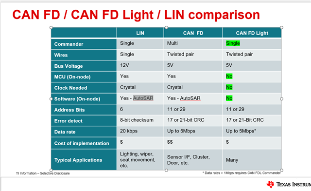

What does the 'autosar' in below chart mean? I thought Autosar is done at MCU side and I don't understand the relationship with CAN/LIN.
Iris,
It is an external LDO, and there is an integrated LDO. I was just stating that the block diagram is showing that the integrated LDO can be used to supply something else and an external LDO can be used.
AutoSAR is an Automotive software abstraction layer developed by third parties. AutoSAR is an industry standard and it is indeed a part of the MCU side of development, but would be specific to the transceiver/SBC being used.

Hi Eric,
What is the relationship between autosar and transceiver? Does the abstraction define the specific transceiver should be chosen?
