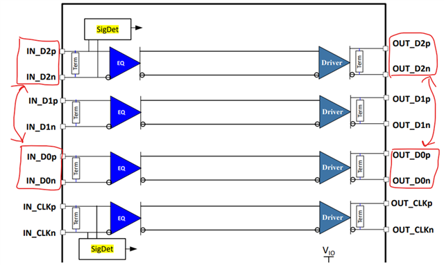

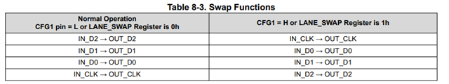

We want to make sure that could we swap the lane between lane 0 and 2 for easier layout?
We're not sure if the SigDet matters or not.
There's no protocol translation, just pure HDMI2.1 redriver function.
