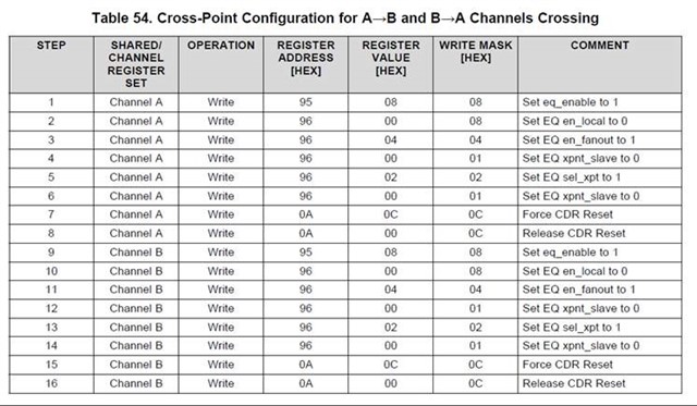

Hi Expert,
my customer is using DS250DF410 in EE Switch, we meet a crosspoint function failed issue now.
issue description: crosspoint mode failed but CDR is locked, 0x78 is 0x30
test we did:
  • for the straight mode, CDR could lock, 0x78 is 0x30, all the link in Switch chip side are successful, we could see the normal data.
  • for the crosspiont mode, CDR could lock, 0x78 is 0x30, but the end Switch chip couldn't detect the signal
  • for the fanout mode, CDR could lock, 0x78 is 0x30, but the end Switch chip couldn't detect the signal
could you help to give some advice? thanks.
BR
Chi
  • Attached the register we have followed for crosspoint mode. we have tried channel0 and 1 in several devices.
    BR
    Chi
  • Hi expert,
    To help you better find the root cause, here is the register we write in crosspoint and fanout mode, also attached all register readback value.
    //set crosspoint(considering mask):
    0xfc register is writen 0x1
    0xff register is writen 0x1
    0x95 register is writen 0x8
    0x96 register is writen 0x0
    0x96 register is writen 0x4
    0x96 register is writen 0x6
    0xa register is writen 0xc
    0xa register is writen 0x0
    0xfc register is writen 0x2

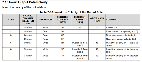

  • Hi Chi,
    The DS250DF410 has a polarity inversion issue in cross mode.  When the crosspoint is in cross mode, the signal's polarity through the device will be inverted.
    In order to address this, our recommendation is to use the FIR filter to invert the polarity while the device is configured in cross mode.
    Please try this out and let us know if this allows for linkup.
    Drew
