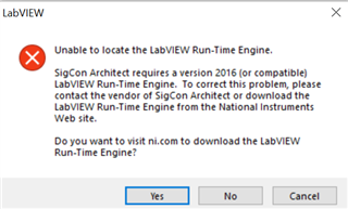

Our customer use the DS160PR410EVM, and the software of GUI.
If the customer cannot complete the installation, is it necessary for the customer to register and download it on NI.COM?
Or do we have other solutions?

Hi Xiaoxiang,
I have not seen this issue before, however there are many different installer packages for SigCon Architect and maybe some of them do not contain the LabVIEW RTE.
Which installer package (SNLC0xx.zip) did the customer try? The product page for the DS160PR410EVM-SMA (https://www.ti.com/tool/DS160PR410EVM-SMA) lists "Texas Instruments SigCon Architect GUI v3 Setup with RTE (Rev. B)" with the file SNLC066B.zip, I would start with that one because the name indicates it should contain LabVIEW.
