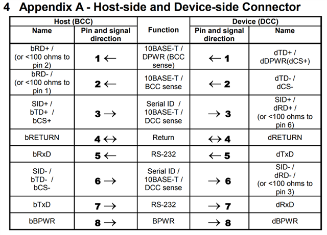

    I can do the Auto-Negotiation to be Disabled but my host will support only 10BASE-T only. I mentioned below specifications of HOST and Device in detailed.
    M-Port device Specifications are: HOST (BCC)
    1. M-Port Host shall provide an IEEE 802.3 10BASE-T Ethernet facility.
    2. M-Port Host Ethernet pinout shall use “hub” pinouts (pin 1/2 RX+/- & pin 3/6 TX+/-) and thereby comply with the IEEE 1073.3.2 Alternate Lower Layer.
    M-Port Devices that Implement Ethernet shall conform to the IEEE 802.3 10BASE-T Ethernet Standard. If Ethernet is not implemented, the Device-side should have the + / - Receive (Rx) Lines (pins 3 & 6), differentially terminated with 100 Ohms or less to comply with the IEEE 1073.3.2 Alternate Lower Layer Specification.
    Connectivity device Specifications are: Device (DCC)
    Sl. No
    Difference
    M-Port Device (Monitor)
    Atlanta Device
    1
    Ethernet PHY line driver
    Current mode
    Voltage mode
    2
    Termination resistors
    Used 100E termination resistors between Tx+, Tx- and Rx+, Rx-
    No external termination resistors used
    3
    Center tap of the isolation T/F
    Center tap is connected to Vcc_2V5
    Center tap is connected to GND with 0.1uF capacitor
    4
    Speed
    Configured for 10/100 Mbps
    Configured for 10/100/1000 Mbps
    5
    Signal termination at RJ45 connector
    Pin 4 is GND, Pin 8 is Vcc_5V
    Used for 1000 Mbps
    6
    RJ45 connector
    Unshielded
    Shielded
  • Hi Alvaro,
    There are couple of queries regarding DP83867.
    1. Did DP83867 PHY will supports integrated magnetics RJ45 connector??
    2. Did this PHY will allow the combined center tap at the secondary side i.e PHY side??
    3. The datasheet says used integrated series termination resistors, what is the value of series termination resistance used for differential pairs?
    Thanks & Regards
    Girish
