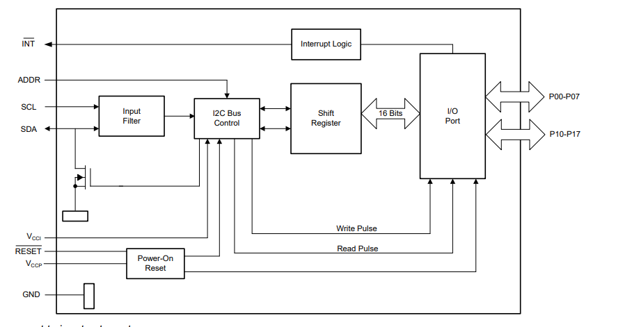

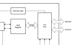

Hi Tyler
Let me ask again. Where is the Port0 and Port1 below block diagram?
And, input the data to TCAL6416, and could TCAL6416 output the data at the same time?
If so, where can I find that mentioned in the datasheet?
best regards
TATSU

The eight pins from P00 to P07 are port 0. The eight pins from P10 to P17 are port 1.
It is not possible to change all sixteen bits at the same time; as shown in figure 8-9, there is a delay of nine I²C cycles (22.5 µs at 400 kHz) between the two ports.
If that delay is too large, you can use two cascaded SN74xx595 shift registers; they would be controlled with SPI, not I²C.
