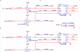

Hi team,
Could you help review the schematic as below picture? thx
The customer seems some problems here. pls check to make sense or not. thx
  • What is the problem?
    There are no termination resistors, which might not matter for slow speeds. I see no other obvious problem.
  • Hi Jimmy,
    There is nothing "wrong" with the schematic per se, as Clemens mentioned there are no termination resistors which may or may not actually cause problems depending on exact device setup.
    Can you please elaborate on the problems that the customer is seeing - scope shots would always be very helpful for us to see the issue.
