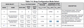

    at the old version image sensor module don't have oscillator. 935 Mode Pin is using RH / RL = 71.5k / 56.2k non-sync internal clock mode as below picture.
    then will change registration configuration to write value 58 in Reg address 0x03. 58(DEC) = 00111010(BIN)
    At this old version situation. Display fine. Hot swap fine.

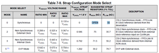

    However the new one we use sync mode. Mode Pin is using RH / RL = OPEN / 10k Sync mode as blow.
    We only change resistor at Mode Pin to sync mode. at first time the display is fine. but when we test hot swap(unplug image sensor then connect back) there will be no display. Would you have any idea about this situation? should we need to change registration configuration again? if yes, what kind of value we should use?

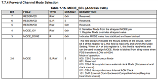

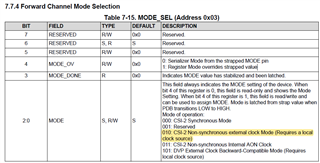

  • Hi Jimmy,
    For sync mode, the 935 mode pin should be strapped to sync mode. In order to confirm you are in sync mode you can read back register 0x03. Bits 0-2 will indicate what mode you are in. For the 936 mode pin you need to strap to sync mode as well. In order to confirm you are in sync mode you can read back register 0x58. Bits 0-2 will indicate what mode you are in (mode is based on back channel rate).
    935 register 0x03 below:
    936 register 0x58 below:
    To be in sync mode, register 0x03 on the 935 needs to be strapped & set to 0x00. For the 936, register 0x58 needs to be strapped & set to 0x5E.
