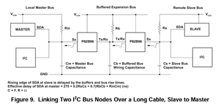

The P82B96 datasheet suggests some configuration for I2C communications, in this, we wish to seek clarifications for the following queries:
Query 1: Configuration
We seek clarification on whether we can use a single pair of P82B96 I2C extenders to interface multiple Slave devices (Sensors) on the remote slave bus with a single master (MCU) on the local master bus with P82B96 transmitting signals over the buffer expansion bus.
The maximum required speed is 400kHz for our use case.

  • 1. The number of masters or slaves makes no difference.
    2. CAT5e cables are designed for differential signals. When you are using them with single-ended signals, avoid crosstalk by pairing the signals with power lines (see figure 13). For noise immunity, you would indeed require differential drivers/receivers. The MAX232 is not differential (RS-232 uses single-ended signals at higher voltages). RS-485/422 is designed for industrial environments and uses more space and power. Consider using LVDS; there are 2+2 transceivers like the SN65LVDS049.

  • Hi Neet,
    I agree with Clemens here. Only other thing to consider is the 400pF limit on the Sx/Sy input/output pins. Rise-time, IOL, and total parasitic bus capacitance would determine the maximum number of master/slave devices that can be present on the bus.

    I agree with Clemens here as well. Another thing to note is CAT5e cable can be approximately 50pF / m. This would mean that over 3 meters the TX/RX pins of the P82B96 devices would need to drive this load. This is doable for this device.
