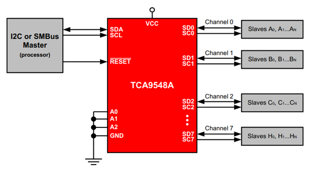

In the customer's application, there are two common-ground 3V3 power supplies in the system. They are "P3V3"(main power supply) and "P3V3_STBY".
For TCA9548APWR, VCC is connected to "P3V3_STBY", input channel SDA and SCL are pulled up to "P3V3_STBY", but 8 output channels SD [0:7] and SC [0:7] are pulled up to "P3V3"(main power supply).
They are wondering does the input pin leak to the output pin. (Does "P3V3_STBY" leak to "P3V3" through TCA9548APWR?)

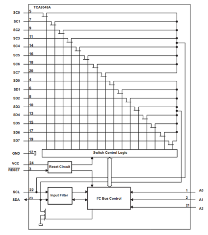

  • Hi Silvia,
    The functional block diagram shows that back powering current would be limited.
    Connections between I2C SCL/SDA and SCx/SDx channels would be high impedance. Input filter presents high impedance input. High impedance exists between the drain/source of the internal passFET and the gate input from the switch control logic. Back powering current would be minimal.
