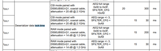

Hi Ryan,
The wait time after PDB release before programming UB954 registers is >2ms.
The UB954 forward channel lock time is below:
The UB953 back channel lock time is typically about 60 ms.
