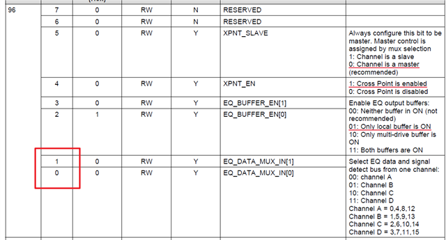

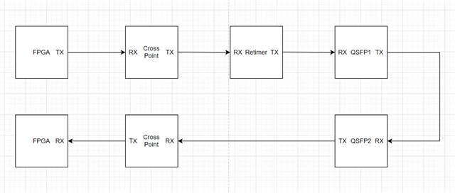

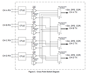

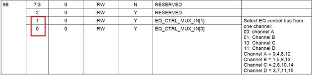

Hi
Four DS125DF1610 are used in our design. When we use them without funciton of cross point and boardcast, one of it shows CDR unlockded on one channel.
The input data come from FPGA in other borad.
We tested power and input clock, the noise of power and ppm of clock are ok.
The registers value are shown below. Is there any problem with regisrer sets? Why CDR unlocked?
ds125SharedRegDump devid 0

  • Hi Michael,
    I notice that registers 0x9B and 0x96 are modified in each channel to enable crosspoint mode - is that the intended setting?
    It seems this register dump may be for the working case with crosspoint enabled. Registers 0x96 and 0x9B should be left at default values if crosspoint is not being used.
    Thank you,
    Evan

  • Hi, Evan
    This is our test data path.
    We use retimer channel direactly, for example, RX of channel 0 connect to TX of channel0.
    In this situation, What values should be set of 0x96 and 0x9B?
    Thanks!
  • Hi Michael,
    If each channel has an independent signal directly routed from RX0->TX0, RX1->TX1, ... , then registers 0x96 and 0x9B should be left at default values.
    If you leave these registers at default, but toggle 0x96[3] to 1, does the behavior you are seeing change?
    Thank you,
    Evan

  • Hi,Evan
    The default values of 0x96 and 0x9B are 4 and 0.
    I checked Figure 3 on datasheet, which is cross point switch diagram. It shows data bus, which controlled by register of 0x96[1:0], and control bus, which controlled by 0x9B[1:0] should be set. For example, if QUAD 0 of CHB RX to CHB TX, set 0xFC[1] to 1, 0x96[1:0] to 01, 0x9B[1:0] to 01.
    If leave 0x96 and 0x9B at default, I think the channels won't work except CHA.
  • Hi Michael,
    0x78[4] and 0x02[4] are both valid bits to reference for CDR lock status.
    Can you clarify how you found this configuration for CHB RX -> CHB TX? This does not follow my understanding of cross-point mode.

  • Hi, Evan
    As it shows in the picture, 0x96[1:0] choose data bus, 0x9B[1:0] choose control bus. If signals are routed directly, for example CHB RX -> CHB TX, we think 0x96[1:0] and 0x9B[1:0]  should be set to 01.
    We will test the situation that 0x9B and 0x96 are left at the default values and give you feedback.
    Thanks very much!
  • Hi Michael,
    0x96[1:0] and 0x9B[1:0] allow you flexibility over which channel's signal detect / EQ control to choose from for the selected channel output, assuming there is some cross-point switching intended.
    For example, if you are writing to channel register C with cross-point enabled, and set 0x96[1:0] and 0x9B[1:0] to 01, then the signal chain becomes:
    RX(B) -> CTLE (B) -> Multi-Point Buffer (B) -> TX(C)
    These registers do not need to be modified if cross-point mode is not intended.
