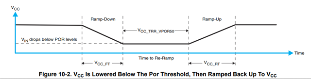

  • Hi Vincent,
    What problem are you trying to solve? Are you asking if there is a toggle output on the PCA9555?
    Are you asking what parameters are needed for a successful reset of the PCA9555? This can be found in the information underneath the power supply recommendations in the datasheet.
    What do you mean by "Is there any way to send a low pulse from one command?"
