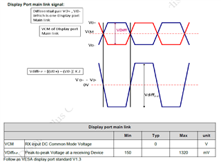

We are preparing to use SN65DSI86 DSI to eDP bridge with AUO eDP panel (G140HAB01.2)
G140HAB01.2 final product spec V1.0_20230519.pdf
The panel main lane signal range is 0.15V to 1.32V  and SN65DSI86 is 0.4/0.6/0.8 in differential level, we though it is matching in different mode.
But we are not sure SN65DSI86 can work with the panel cause the panel AUX signal range is 0.4V to 0.8V and SN65DSI86 is 0.18V to 1.38V.
The SN65DSI86 AUX signal is over the panel may cause not working right ?  Could the signal range be adjusted by firmware or any suggestion?
