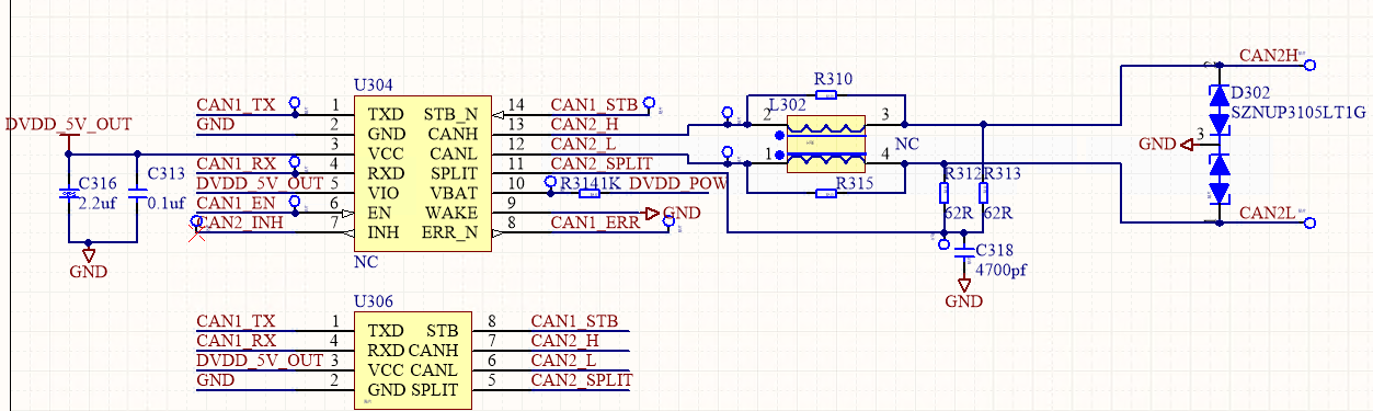

    It appears that the falling edge of the CAN signals is not symmetrical. This is mostly a passive transition where the CAN driver goes from an active dominant state to a passive (higher impedance) recessive state. This means that the transceiver only has a small influence on the shape of this edge where system conditions can have a much greater impact.
    In this case it looks like the CANH signal has a longer fall time than CANL. This is most often caused by an asymmetrical load on the CAN signal. This can be the result of signal routing, passive components, solder imperfections, board defects, or other characteristics of the CAN system as a whole. Is it possible to share the layout of the CAN signal on the board you are testing with? I would like to review this for any characteristics that may impact the common mode signal during this transition. If this information is considered confidential, you may share it to me directly through email as opposed to this public forum. You can find my contact information by clicking on my E2E name.
