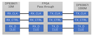

I'd like to know about communication between 10Base and 1000Base.
My customer is considering the following structure.
Can it communicate from a 10M EtherPHY to 1000M EtherPHY when the FPGA does no processing?
Sincerely.
Kengo.
  • Hi Kengo,
    I don't think this can be achieved without FPGA processing because10Mbps operate in the 2.5MHz clock speed where as 1000MHz operate in 125MHz. I think it required FPGA to have the ability to change the clock speed.
