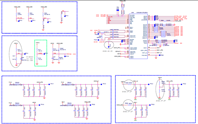

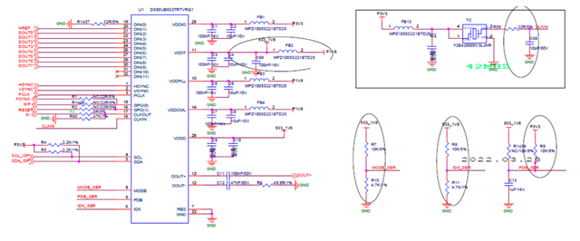

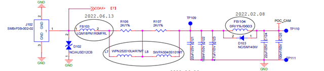

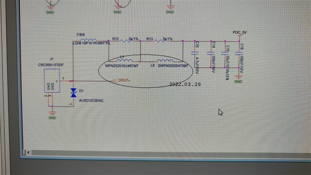

When I read the datasheet of DS90UB914A-Q1, I found that the datasheet described that DS90UB914A-Q1 could match DS90UB913-Q1/DS90UB935-Q1/DS90UB953-Q1, but there was no DS90UB933-Q1. Is there any problem with DS90UB914A-Q1 and DS90UB933-Q1 matching work?
